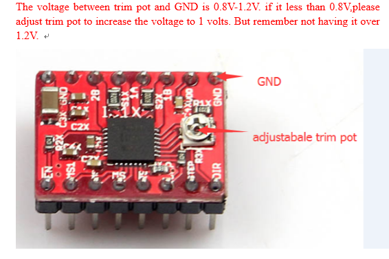

hi,please shoot a clear video or photos while it is printing frist layer. and from the words"i have cilbrated everything except that in the beggining the extruder motor still blocks and the first layers are not fully covered with filament and the Y axis on every print after 1-2 minutes freaks out printing nonsense".
it seems that the z homing postition is too closed to print bed. if so, please increase z home position a bit.
btw,did you increase trim pot voltage of all A4988?
