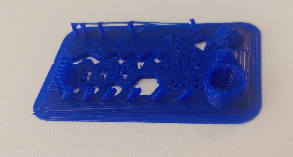

I have completed assembly of my M201 (my very first printer) managed to get a test printed.
Here are some of the initial issues I encountered;

The test print is based on this http://makerware.thingiverse.com/thing:1019228 and has come out reasonably well for a first attempt, but not perfect.
I used pronterface for the SW, which itself used slicer for the preparation.
First (actually second) print attempt
My first question I have is does anyone have a good set of defaults for slicer specifically for the M201? I have seen a few on the forum but not sure they are specific for this printer, with it's dual extractor setup and all.

Thanks Mark, yes I did look there, the very first partial print had some stringing, and some layer shifting (in both X and Y).
To remove the stringing I added retraction of 3mm (is that reasonable?)
To hopefully correct the layer shifting I adjusted the current of the drivers as mentioned, and also adjusted acceleration from (I think) 1000 down to 750.
Both these seem to have worked in the first full print as shown, and the next stage of refinement will be a little more subtle.
It would really help to have a default slicer config to start from. I have made so many tweaks since I started, and never actually had a config file saved to start, so have now way of getting back to a good basic setup for this printer.

yes I think is proper. I have tried Max 6mm retraction and 100mm/s retraction speed on this printer, when print with 100%/0%, that means only with filament one, the result is quite good without much stringing. But with two colours still not that good....and the driver voltages, I have them all adjusted to 1.0V, works quite good. Usually the voltage is about 0.8-1.2V.
