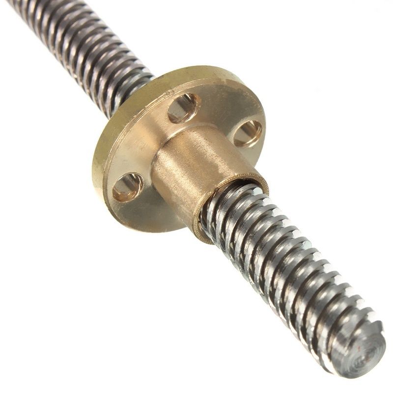

One of my rods bent so I bought 2 of these will that make a difference??

will it fit the couplers and the holes on the frame? If so, then I think you need to calibrate the steps/mm for the Z axis, check out this guide:

ok this is the kind of I have .. M8 x 2 Trapezoidal thread ..im going to do some more search on how to set it up??
Re: Z motors dont move up when printing.
The original one for the I3X Z axis is 200*16/1.25=2560, so I think then your new rod would be 200*16/2=1600.
