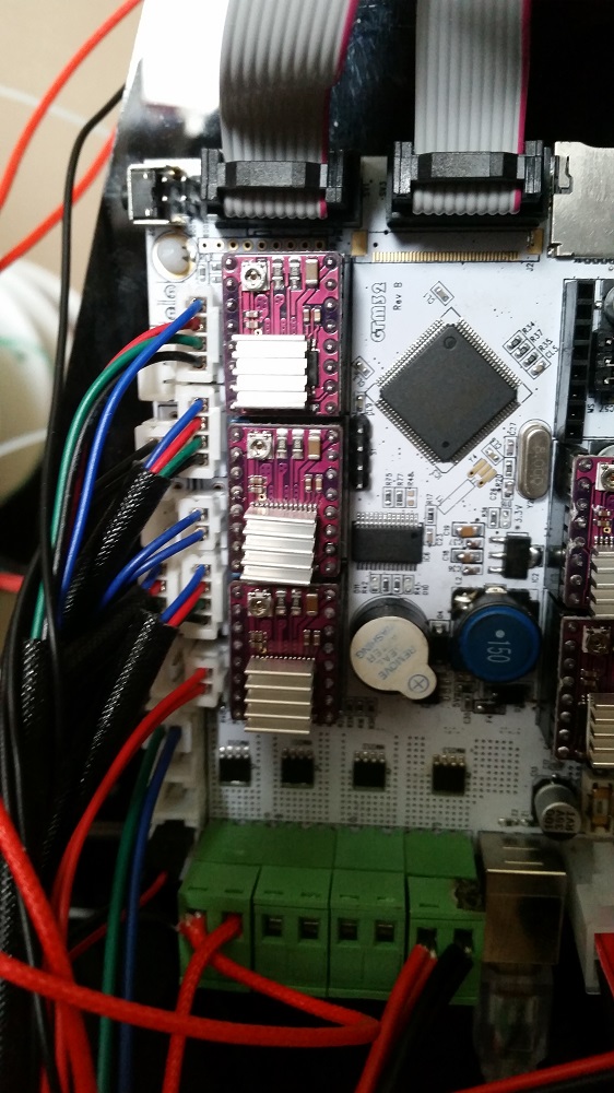

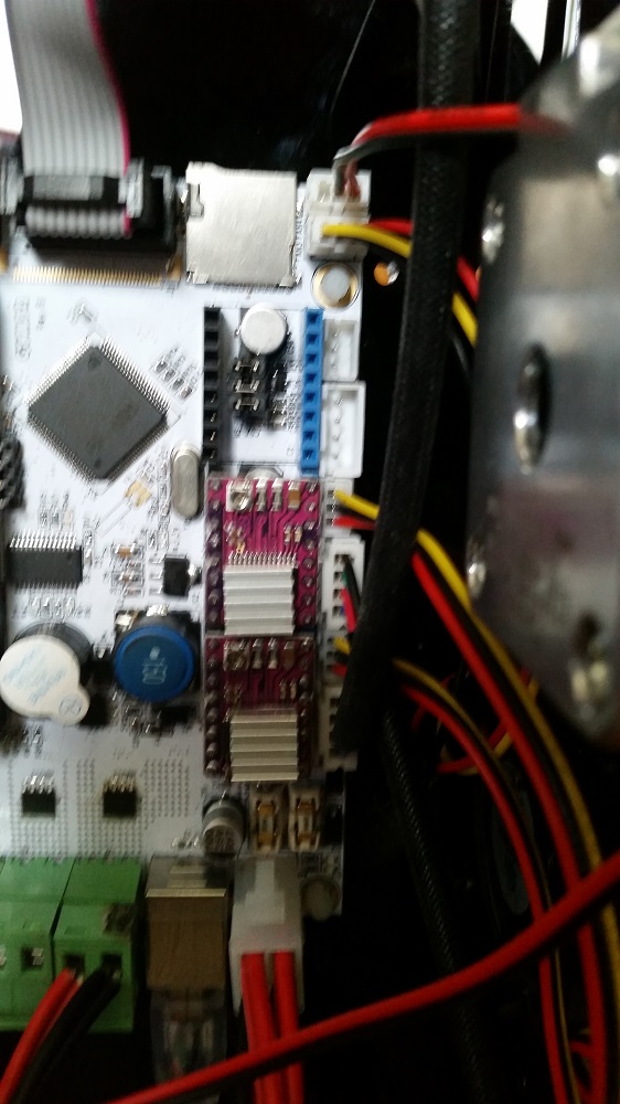

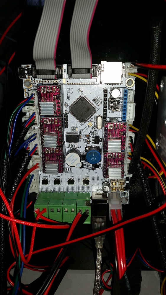

Hi Mark,
I transferred the cables 1 by 1 from the old board to the new board so they should be in exactly the same positions. I think the new board was a Rev A (large USB plug rather than mini plub - but the board has Rev B printed by the name (see pictures)) rather than the original which was a Rev B board. Power supply has been operating successfully before the board blew up and I have not changed any settings or voltages on this so should be OK.

hi,friedn,you plug the drivers with wrong orientation,you also didn't unplug all the number 1 and number 2 jumper caps as shown in the pictures.

Thanks James. The pictures on the build instructions were not clear. I have reorientated the drivers on the board and removed the jumpers from pins 1 and 2 but, unfortunately, I still get smoke wafting off the board when I switch on and no activity whatsoever so I assume that the board has been zapped by my initial action?
I have reordered yet another board from Geeetech!
Can you advise if the driver boards would have survived the incorrect plugging or will these need to be replaced as well?

If the drivers are burned out, usually there will be a burning hole on the center of the driver chip, all my 4988 have such a black hole when burned out.
