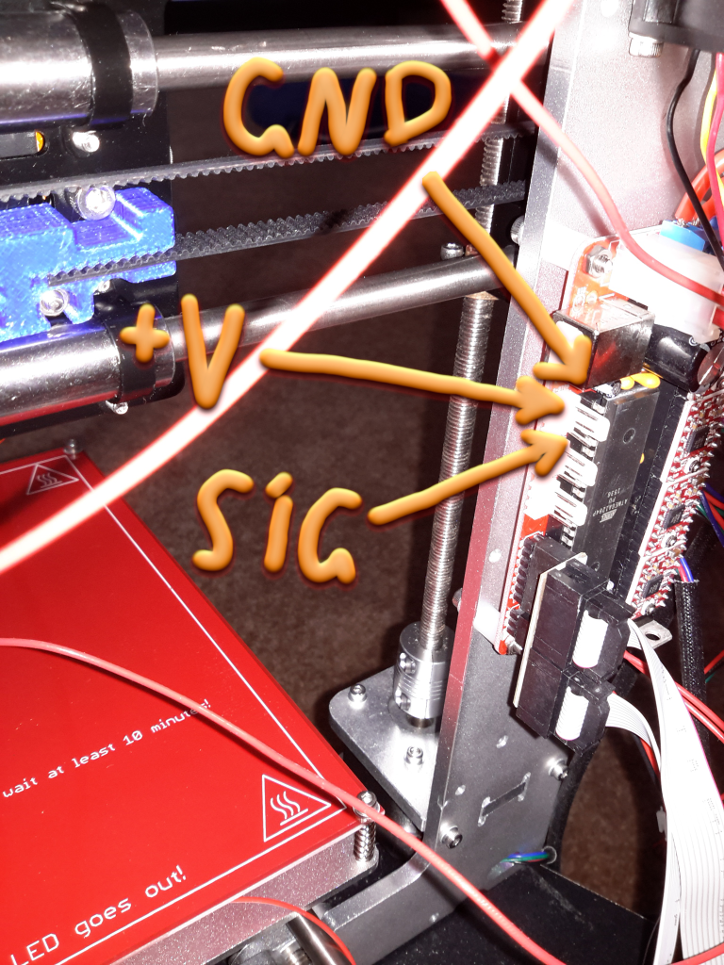

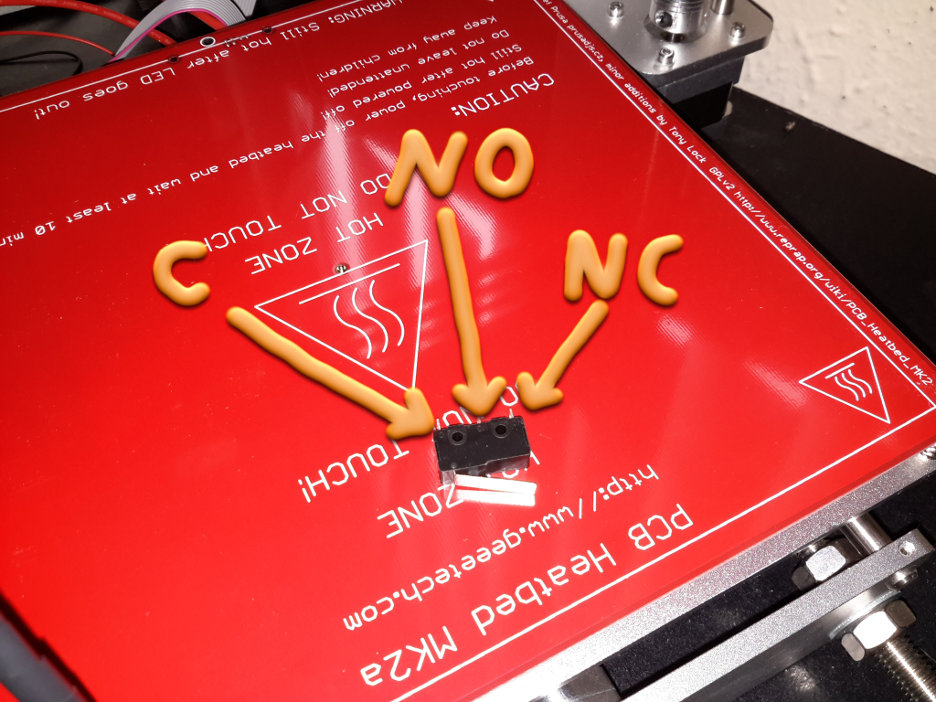

I just got Geetech aluminum Prusa I3 printer and while assembling ran into few problems. One of those problems is I'm failing to connect End stops to the control board. My first idea was to connect "C" and "NC" on end stop to "Sig" and "Gnd" on the board. That does nothing. What am I doing wrong? Also I'd like to know how can I tell if end stops work? Thus far I have been using "auto home" and clicking the end stop.

Connect the endstop to the sig and GND , and the wirings to the NC and C . Did you get the building instructions of this printer? It includes all the wirings you want. you can download it here:
http://www.geeetech.com/geeetech-alumin ... p-944.html
And the endstops, you can check the endstop status with the M119 command.When the endstop is released, send command M119 from the repetier host it will report "open", and when it is pressed it will report "triggered".
