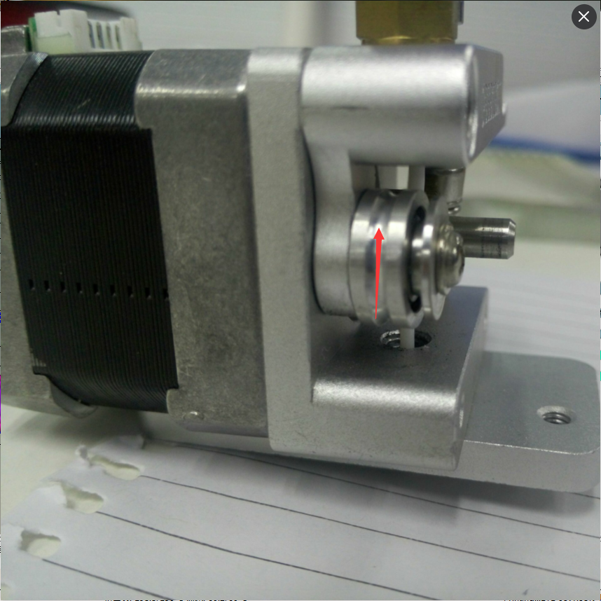

Have you plug your filament into the Nozzle Throat completely?Like the filament must be stay the groove of the pulley,look at the pic below...
Then if the position of filament is all right,check out the following:
1) Checking if the extruder temperature has reached the preset temperature, the lowest working temperature for extruder is 175°set up in the firmware. When heating, if it do not reach the temperature you set up(over 175°),the extruder will be still at the left hand corner(home position) rather than moving to the center of print bed.
2) if the temperature could reach the temperature you set up, and x,y,z stepper motor rotate correctly, but the extruder just move over the print bed surface and extrude anything. In this case, please check whether the stepper motor of extruder rotate or not, or check if it’s direction is reversed that it retract filament. In addition, please see if the nozzle is clogged.
