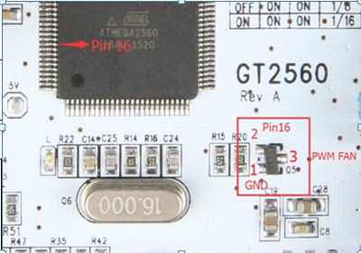

Having heard about you guys have the problem that the PWM fan is not working.And you can check this:
the PWM fan is controlled by the pin16 of the mainchip. When you turn on the fan, then the voltage
between the pin2 and pin1 of the mosfet is 0~5V, and when off, it will be about 0V.

I know this is an older post, but I have no voltage at the PWM socket but when I check for voltage across pins 1 & 2 on Pin 16, I get 0v fan off and 4.36v fan on. Would there be any other reason why I wouldn't get voltage there?
Note: Never mind, I just figured out that the wiring diagram is incorrect. + is at the top. It's working now but I have an older fan so I don't have the complete range of speeds. I can only get from about 50% to 100%. Anything less and the fan just stops.

Hi William, i also have a problem with the pmw port. I can't control the fan, it is running all the time.
After i added an object cooling fan on the pmw fan port i noticed that i can't control the fan speed, the fan is running all the timer and i cant shut it off trough repetier or the LCD panel.
I took a mulimeter to check the voltage on the two pins like they said. When i choose on the printer fan speed 0 then i have 3,16V between the pins, instead of 0V between the pins.After i raised the fan speed to 255 i got 6,16V. So the fan keeps running all the time. I think the mosfet on the board might be broken, like they said in the forum. The firmware on the printer is the original, as it was delivered.

here is a way to connect a 2 wires fan to the PWM-FAN connector of the GT2560.
Note : my fan is a brushless DC 12v 0.15A, a very common one.
- the POSITIVE wire of the Fan (in general, it is RED) : connect it to the top pin (nearest of the board edge) of the PWM-FAN port of the GT2560 (with a yellow dot on the GT2560 scheme in documentation)
- the NEGATIVE wire of the Fan (in general, it is BLACK, or another color with a black strip): connect it to the middle pin of the PWM-FAN port of the GT2560 (with a black dot on the GT2560 scheme in documentation)
Note that if you revert them, the fan will not run.
You can control the speed of the fan via the LCD, via REPETIER-HOST buttons/slide, via g-code, or via le slicer config :
- via LCD : menu Control / Temperature / Fan Speed : 0 = Off, 1 to 130 slow speed with 'vibrations' (avoid this range !), 131 to 255 real adjustable higher speed range. The 1 to 130 range 'vibrations' is due to the fact that my 1$ fan is not a 3-pins real PWM fan and it cannot start rotating at low power. Perhaps that this range can be reduced with better quality fans, or real PWM fans.
- via Repetier-Host / Manual Control : with the fan slide : can stop the fan, or turn it on with some minimum speed (also with the low 'vibrating' range) to maximum.
- via g-code : M106 Snnn : nnn=0 for off, 255=max speed (also with the low 'vibrating' range). You can also add this code in the Start G-code when using PLA M106 S255 to cool the layer, and in the End G-code M106 S0 to stop the fan.
- via the Slice config : in Filament Settings / Cooling : a lot of options for a clever setting arround the fan for bridges, smaal parts, layers, ... etc
Hope it helps.
