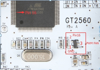

Having heard about you guys have the problem that the PWM fan is not working.And you can check this:
the PWM fan is controlled by the pin16 of the mainchip. When you turn on the fan, then the voltage
between the pin2 and pin1 of the mosfet is 0~5V, and when off, it will be about 0V.

I know this is an older post, but I have no voltage at the PWM socket but when I check for voltage across pins 1 & 2 on Pin 16, I get 0v fan off and 4.36v fan on. Would there be any other reason why I wouldn't get voltage there?
Note: Never mind, I just figured out that the wiring diagram is incorrect. + is at the top. It's working now but I have an older fan so I don't have the complete range of speeds. I can only get from about 50% to 100%. Anything less and the fan just stops.

I took a mulimeter to check the voltage on the two pins like they said. When i choose on the printer fan speed 0 then i have 3,16V between the pins, instead of 0V between the pins.After i raised the fan speed to 255 i got 6,16V. So the fan keeps running all the time. I think the mosfet on the board might be broken, like they said in the forum. The firmware on the printer is the original, as it was delivered.

here is a way to connect a 2 wires fan to the PWM-FAN connector of the GT2560.
Note : my fan is a brushless DC 12v 0.15A, a very common one.
- the POSITIVE wire of the Fan (in general, it is RED) : connect it to the top pin (nearest of the board edge) of the PWM-FAN port of the GT2560 (with a yellow dot on the GT2560 scheme in documentation)
- the NEGATIVE wire of the Fan (in general, it is BLACK, or another color with a black strip): connect it to the middle pin of the PWM-FAN port of the GT2560 (with a black dot on the GT2560 scheme in documentation)
Note that if you revert them, the fan will not run.
