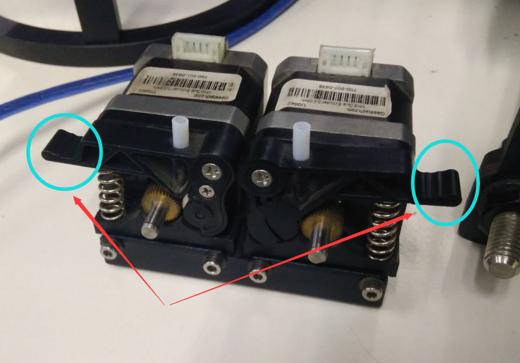

Re: Upgrade ProB into a Dual Extruder Model
You should know different of here(not in same side), this is why i suggest you dual extruder and dual extruder holder.
- not same.png (668.87 KiB) Viewed 115955 times
oww, but should be possible to disassemple one of the "sameside" extruder and mount it in the opposite side, right?
I am also currently interested in this. I am trying to do the same thing. As many users want to just upgrade to dual extruder, it would be great to buy one more extruder to upgrade. Basically, second extruder on the dual extruder is mirrored version. Actually, the stepper motor, fans and the heat sink don't make any difference, as they are "square". The only part, which is a problem to such an upgrade is those black plastic parts, which aligns the filament holder gears to eachother. That prevents to align 2 extruders side by side. The pictures on the geeetech store website show these parts to be metal (aluminium maybe?). A single extruder costs $30, a dual extruder $96. In order to save $66, I am considering several options here:
1) Order a single extruder in a mirrored orientation if possible.
2) Order a single extruder either plastic or aluminium and cut the marked part in william's picture above to fit in.
3) Order a single extruder and order a mirrored version of that plastic/metal part if possible.
Option 2 has another tiny issue. The way it looks from the pictures, the 2 hot ends will have different distances compared to the original dual extruder! I guess that can be configured either in the slicer.
