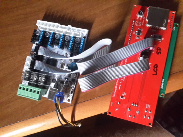

Normally LCD 2004 is indeed compatible with GT2560, how do you connect the LCD with your board, can you post a picture?
robmar
Posts: 6
Joined: Sat May 21, 2016 5:58 am
Re: Confused between different LCD2004 models
Post by robmar »
Hello, as per your request I'm attaching the picture of the connections layout board <> lcd, that's the straightforward standard one (EXP1 to LCD and EXP2 to SD)
But, as I told, the problem comes not from the connections, but from a major difference in the hardware of the two LCD2004 boards I have.
If you look at the schematic of the GT2560 http://www.geeetech.com/forum/viewtopic ... 18&t=16259) the supply pins of the LCD connector are 1 (VCC) and 2 (GND)
But since on the new LCD board I got (red pcb, from RepRapDiscount) I wasn't getting the expected voltage from the GT2560, measuring directly across the voltage regulator chip, I analyzed further and found that this particular board, although declared "compatible" has an LCD connector configured in a completely different way.
See the schematic http://reprap.org/mediawiki/images/7/70 ... scount.pdf where the supply pins on LCD connector are pin 10 (VCC) and pin 9 (GND)
No wonder I couldn't find the expected voltage on LCD board !!!
But now, since it is evident now that on the market are present two incompatible versions of the LCD2004, my concern is how to tell in advance, before buying a new one, if the advertised board will be of the first kind (supply pins 1-2) or the second kind (supply on 9-10) since all sellers are declaring them fully compatible, while, at least for what concerns the GT2560 board, they are not.
It is enough to look for a white-pcb display board to get the right one? Still confused...

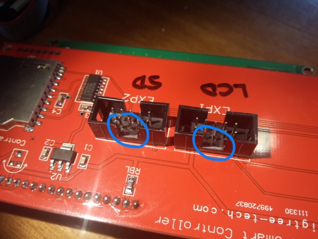

've found a decent workaround to fix the LCD2004 incompatibility issue.
Being rather stubborn and don't giving up easily, studying the schematics suddenly it came to my attention the fact that the different pinout on the red board were nothing but the same configuration of the GT2560, only... mirrored! Thus pin 1 = 10, 2 = 9 and so on. Having discovered this, I've cut right away two new openings into the IDC ribbon socket's walls in order to accommodate the female plug reversed by 180°

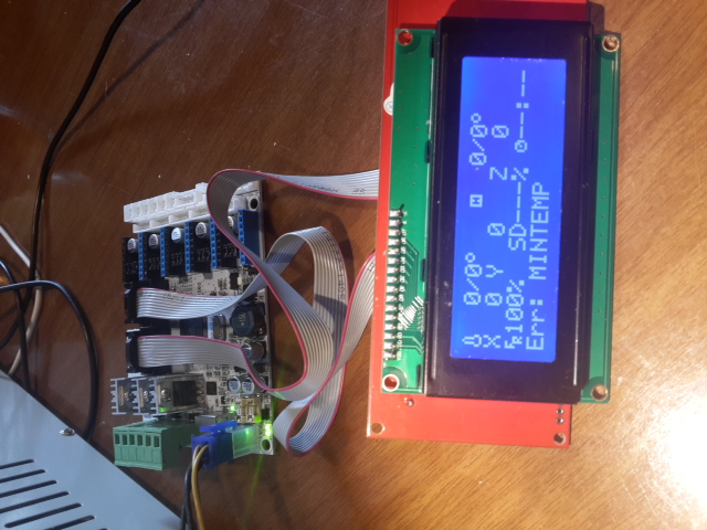

And then, make it or break it, I've powered the boards and... bingo!
So, in the end, it turns out that the same board comes in two versions, being the only difference the orientation of the two 2x5 IDC connectors. Hard to tell where's the logic in it, but the positive fact is that the problem can be easily solved with a pair of clippers!

After an half day trying to understand what's happened, your solution solve my problem in five minutes.
Now my LCD runs.
