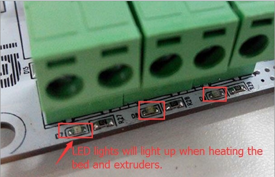

Additionally,extruder heats up uncontrollably,it also can be the mosfet's problem,cuz it is the mosfet that controls the extruder to heat up.So check the mosfet like this as the pic below shows:manually heat up the hotbed and extruders, if the LED lights under the hotbed and extruder slots all lighted up, then the mosfet that controls the heating is good.
If not, the mosfet might be dead.
