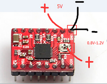

I have Geetech 3d Mini desktop printer and sometimes the extruder has difficulties pulling the PLA, is it possible on this printer to add another pulling motor ?

Maybe the driver module's(A4988) driver abilities is not enough.You can increase it by adjusting the potentiometer.Refer the pic below:

Thanks for the quick response, I'll try checking it out but not sure this is the issue, sometimes the material comes a bit tight on the wheel and then the printer has difficulties pulling it, I saw in different printers that they have additional motor that help pulling the material.

Well,you can check it first and tell me what it goes on.Additionally,one motor is enough cuz it mainly matters the driver abilities.

HI!! I have the same problem! :( i read in some articles that i have to test the voltage (Vref) without the jumper, it is correct? and in this post i read that it is necessary shut off the printer when i am adjusting the potentiometer, is it true?...

It may not true,if you cut off the power of your printer,then how does the voltage come from?
