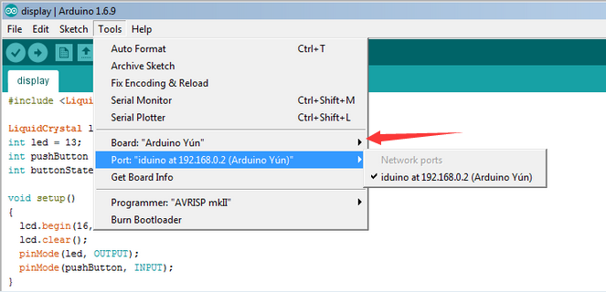

Look the image, I just select the arduino yun and the port of comunication wifi -> 192.168.0.2 that i access fine from my webrowser, OK
What i need to change?

Re: Iduino Yun Shield
luis_filipe wrote:Look the image, I just select the arduino yun and the port of comunication wifi -> 192.168.0.2 that i access fine from my webrowser, OK
Thanks a lot for your replay
Hi,my friend
I'm thinking shouldn't it be your MEGA2560 ?
