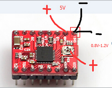

So sorry to bring you that trouble.And its our fault not to update our user manual for Pro B,cuz we have been using 42SHD0034-20B instead of 42SHD0217-24B.The engineer said they two have not much difference and both belong to 42 motors.About the losing step problem,i think your can check if the corresonding driver voltage of the motor is enough or maybe the relevant timing belt is too tight.
