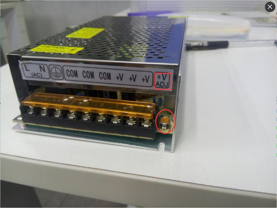

So what residential electricity is in your country and have you switched the 220V/110V?If you choose right voltage,then adjust this one in the pic below and see if the DC output could reach 12v.

kylon_982@hotmail.com wrote:already checked, if i set 110v, nothing happen light turn off and i dont have output v. If i set it to 220v, lights turn on, and output V changes between 8-8.5-9
What AC voltage your country uses???And you mean you have adjust the potentiometer i told you,then it couldn't reach 12V?
