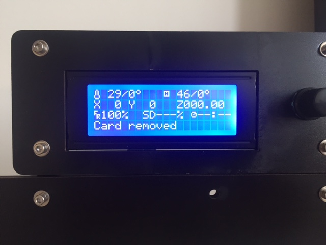

I attached a screenshot of the LCD
I also did some more debugging. If I do not connect my computer with USB and use the LCD controls to heat up the bed, the firmware resets. You can see it here:
https://www.youtube.com/watch?v=dnwPgx6NZ2w
If I have the computer connected over USB and use Printrun to heat up the bed, the firmware does not reset but I get this strange blinking on the board:
https://www.youtube.com/watch?v=Oloh4mXtfew
Is it possible that with the heated bed on the whole electronics reboots and reboots and reboots and that's why it seems to be blinking? What do you think this is, control circuit problem or maybe a power problem? I know that a 15A power supply is not very powerful, can that be causing a behaviour like this?

OK,looks like everything is ok.I guess it is caused by the unstable DC output.Some questions and tips:
1.Was your heatbed rated voltage is 12V?
2.Did your fans voltage reach 12 V when you're heating up the hotend?
3.What happens when you exchange the hotend cable and the heatbed cable on the motherboard?
4.Try another PSU if you have one in your hand.
