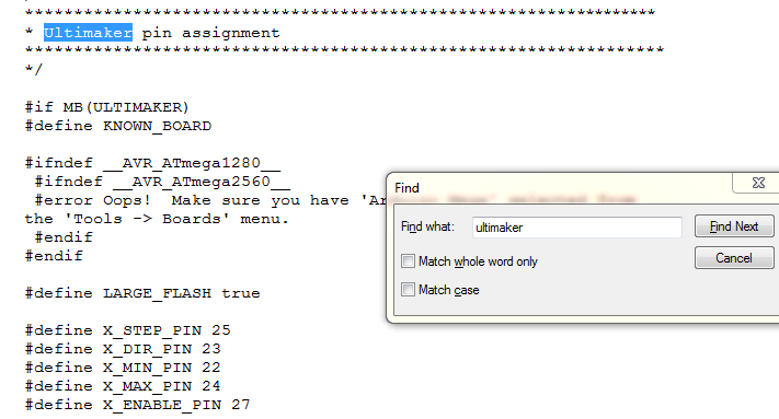

First, open your firmware, find the pins.h file, open it with the wordpad, find the ultimaker part,
then swap the corresponding pins settings of E0 and E1
