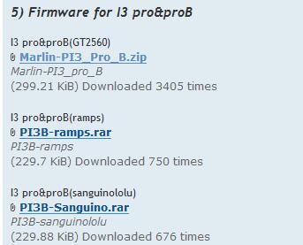

Don't worry.Maybe you have a wrong firmware?Did you download your firmware from this link:
http://www.geeetech.com/forum/viewtopic ... 20&t=17046
1.What motherboard is your printer?
2.Which Arduino version did you use?
3.And did you upload the firmware successfully?

Hi!
Yes, i downloaded and installed the firmware that you linked correctly.
But i finally after many many hours of troubleshooting that in the configuration.h file EEPROOM was disabled.
Once when i enabled that everything worked as before.
This took me several hours to find because none of my axis was moving.
