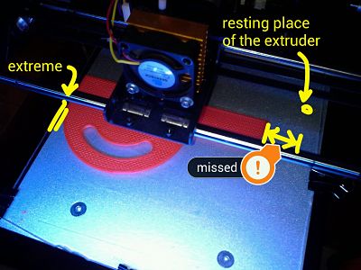

I have an issue with the position of the piece into the bed.
It follows that the printer can’t print their max capacity because the piece to print is displaced too far to the left. Please see the picture. My printer is a Mecreator2.
What can I do for resolve this?

I modified some settings and works on the maximum size. But I still think it is wrong, in fact it has loaded data showed in the user manual.
But finally it works.
Thanks.

Added 10 to Bed left and front, 1 to Area width and depth.
If I put 160 and try to print the same size, the extruder leave the bed, but if 159 is going well, so I'm like 161 for print 160 and is ok 8-) .
The bed size is 180x180mm, setting with 160x160mm with extruder at 10x10mm into the bed, should be go well, but dont.
