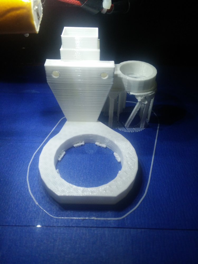

Finally something that looks ok again....I had to increase the voltage a bit more to stop klicking/missing steps
I do not want to risk measure at the moment as I have 2 hours left on this print ( I did shortcut yesterday, the printer made a reset in the middle of a print)
Here is the link to the print thats on the table atm.
http://www.thingiverse.com/thing:1540434
Re: Prusa i3B
This is the print...The result are not great but OK for now.
