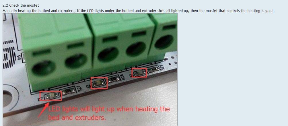

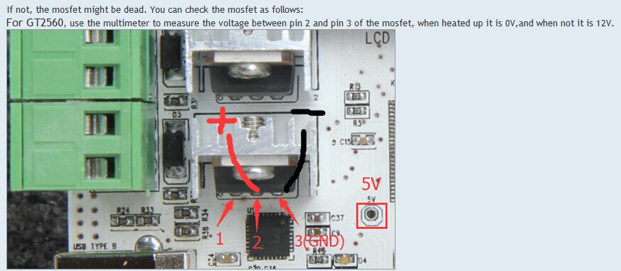

Did you have a bad mosfet for extruder1?I think you can try checking the mosfet:

I don't mind checking, but your request for me to check the mosfet doesn't make since to me. Obviously the mosfet is functioning. The extruder 1 heater comes on and stays on once either of the extruder heaters are triggered. It just doesn't turn off. Seems like a programming/firmware issue.

modsbyus wrote:I don't mind checking, but your request for me to check the mosfet doesn't make since to me. Obviously the mosfet is functioning. The extruder 1 heater comes on and stays on once either of the extruder heaters are triggered. It just doesn't turn off. Seems like a programming/firmware issue.
I don't think it is a firmware problem if your firmware is the one comes with the printer.And have you checked the mosfet?In my opinion,it is the mosfet that controls the heating's on and off.So i said maybe it was the mosfet problem...
