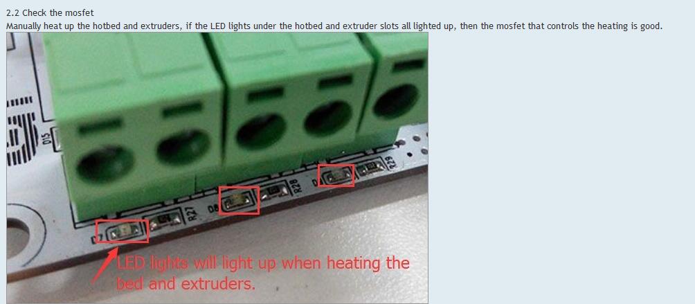

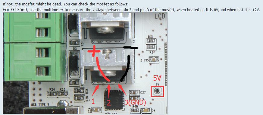

Did you have a bad mosfet for extruder1?I think you can try checking the mosfet:

I don't think it is a firmware problem if your firmware is the one comes with the printer.And have you checked the mosfet?In my opinion,it is the mosfet that controls the heating's on and off.So i said maybe it was the mosfet problem...
