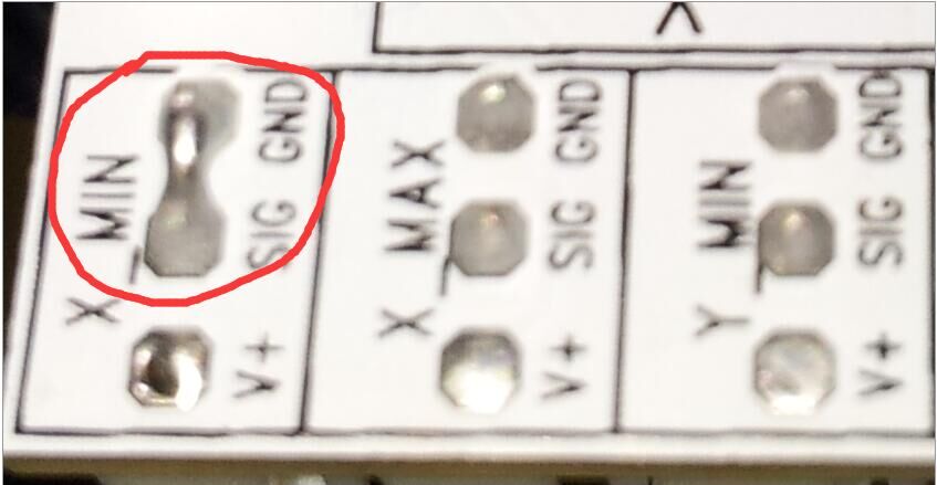

You can unplug the two thermistors to see how the LCD displays.If it still reads high temp,you can check if the board has a problem on your T0/T1 port like the following pic:

I mean the back of T0 pin on your board,and see if it has the same issue as the pic i attached.
