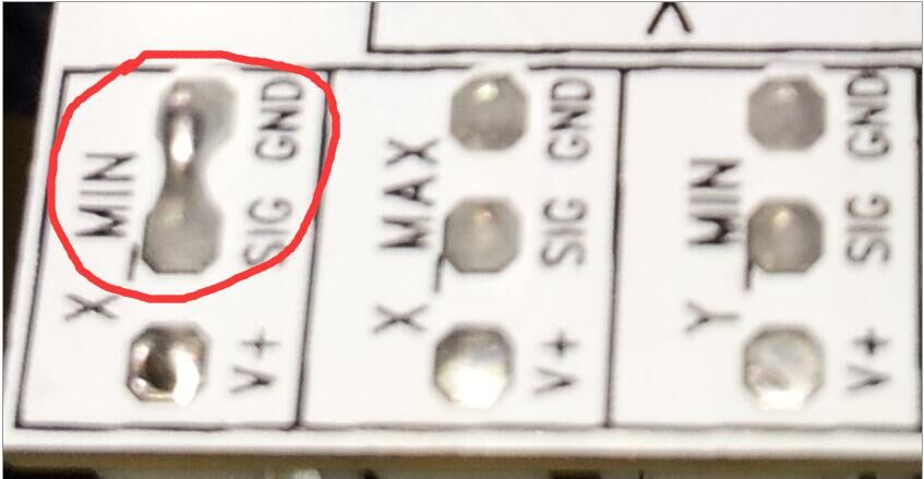

brisrascal wrote:Will check on the DRV voltage and step settings. However, for the thermistor circuit i checked and there are no shorts. What can be the problem? I have switched betwen two thermistors. One thing though. With out the thermistor installed in T0 the LCD reads 500 degrees, after i have installed the thermistor in T0 it drops to 476 degrees. I have nothing else plugged in.
You can unplug the two thermistors to see how the LCD displays.If it still reads high temp,you can check if the board has a problem on your T0/T1 port like the following pic:

by brisrascal
i can't seem to find the location of the points. can you show me where on the board?

by William
brisrascal wrote:i can't seem to find the location of the points. can you show me where on the board?
I mean the back of T0 pin on your board,and see if it has the same issue as the pic i attached.
