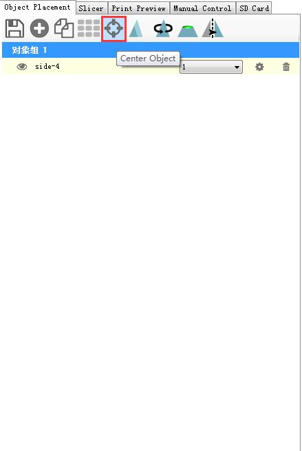

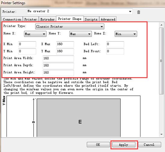

Have you forgotten this step ever?
If you've done that,then the object didn't print in center,you can refer to the following post to make some settings modification:
http://www.geeetech.com/forum/viewtopic ... 819#p27819
Or you can "center object" after you "add object",which may work:
