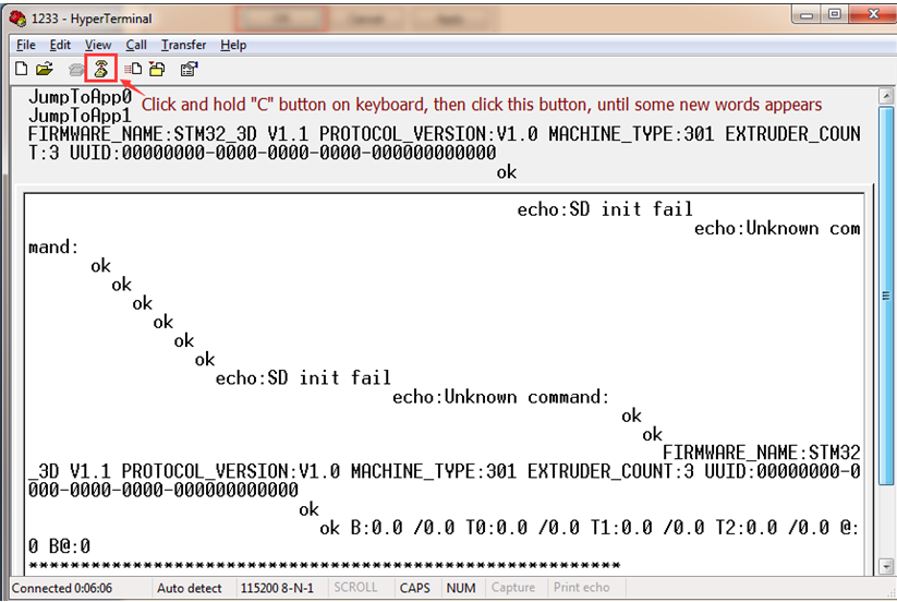

1.Connect the USB cable to your computer.

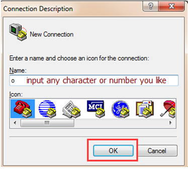

Open HyperTerminnal,then input any character or number you like:
2.Select the corresponding COM port:

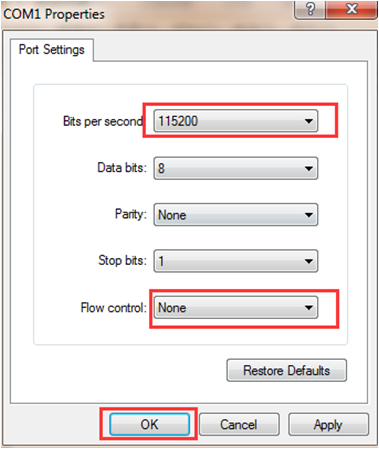

3.Select the Baud Rate "115200" and Flow control "None":

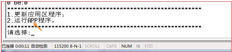

4.Click and hold "C" button on the keyboard,then click the following button until some chinese writings display:

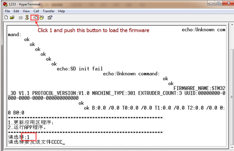

5.Push "1" on the keyboard and the following button in HyperTerminnal to load the firmware:

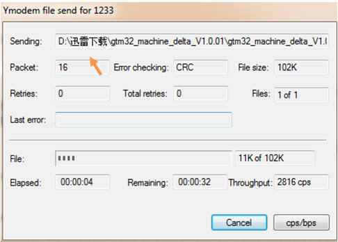

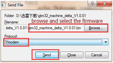

6.Load the firmware and select "Ymodem" as protocol,then send the firmware:
Note:
1. When uploading the firmware, you can only use one port on PC, or it will hints that the port is occupied, and the burning can’t be finished.

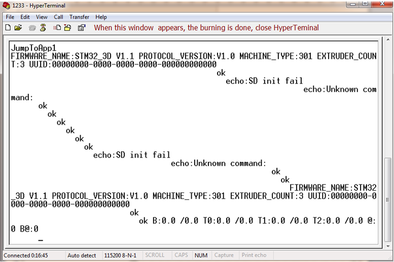

2. If some error messages appear during uploading, close the software and try again.
Let me know please if you have any question about it.

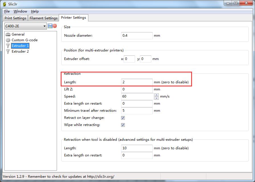

And what value is your restraction length in slicer setting (see the following picture)?
