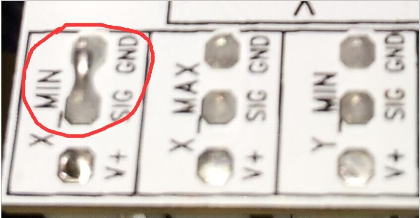

3.Check if there is a problem on the back of your board like the following pic shows:

3)From behind the board seems ok...
