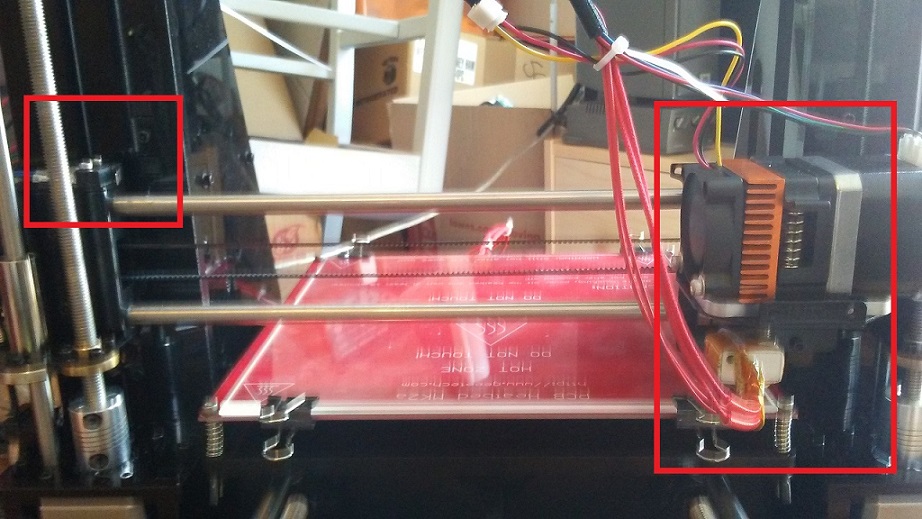

The page that you sent me to in order to fix the X axis says that the home position is supposed to move up against all the endstops. Mine homes with the extruder to the far right, but the endstop is on the left.
Is this the correct home position?
Attaching a picture to show what I am seeing.

Re: Acrylic Prusa I3 build issues
Nope,the home position you attached should be the left side where the X endstop locates.
Looks like you home X axis then the extruder motor move towards right end?
If it does,the X motor has a wrong direction,you can confirm it in"Prepare->Move Axis->Move X" to check if it moves correctly.
Refer to the following post to change the X motor direction:
http://www.geeetech.com/forum/viewtopic ... 17&t=17037
