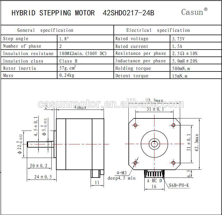

X/Y/Z motors are 42SHD0217-24B
The current rating are 1.5A as I found from internet(file attached).
Based on "https://www.pololu.com/product/1182", the calculation for adjusting current limit on A4988, Current Limit = VREF × 2.5. So, I used this formula and adjusted VREF= 0.6V, (VREF= 1.5A/2.5=0.6V). I measured the VREF on A4988 before adjustment, they were ranged from 0.51V to 0.55V. I do not know the current sensing resistor value on the A4988. After VREF = 0.6V setting, I did not hear the motor miss any step, so far so good. I installed the heat sink since now the current limit is higher than 1A.

- 42SHD0217-24B-00.jpg (72 KiB) Viewed 23579 times
