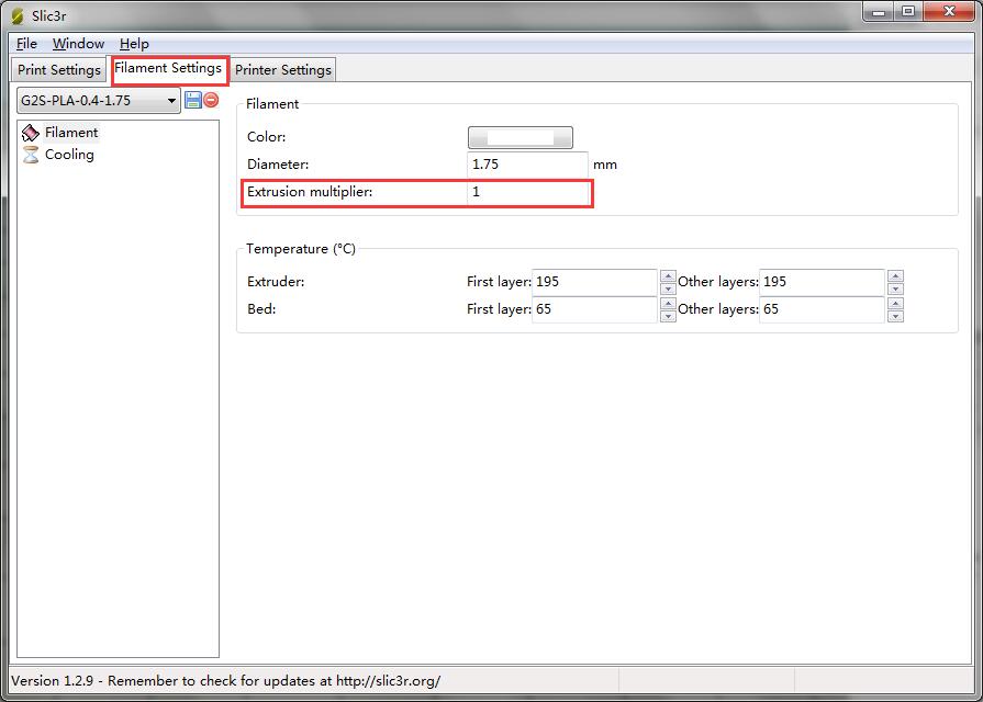

How do I increase the flow?
Thanks
Re: Geeetech m201 under extrusion
A fine mesh?How did it look like?And how about extruding with you hand pushing down the filament?
You can increase the flow in slicer settings:

How much to increase multiplier?

How much would you increase the flow settings?
Thanks
Usually,the value ranges 0.9~1.1,i set it to 1 most of time.
You said the filament came out normally when you pushed by hand,so maybe the extruder part has a problem somewhere?

Thanks It now works fine. Set it to 1.1 and makes good print.
