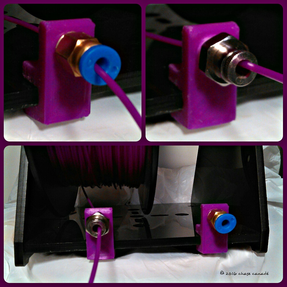

Designed by Robert Martin aka nukem, this is a small but functional print designed for the Geeetech Acrylic Spool Holder.
Once tapped using a 1/8th inch BSP-PL (parallel) tap, you can install the 1/8th inch BSP fittings for either 1.75mm or 3mm filaments.
Shown in the above image with two different style 1/8th inch BSP Quick Fittings, 1.75mm shown.
Printed using the Geeetech i3 Pro B with Geeetech PLA (purple)
