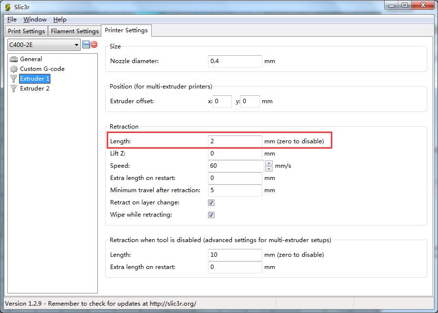

15 mm?Unbelievable...
Did your extruder have a wrong direction?
You can set the value to 0 in Slic3r to disable the restraction:

That was exactly what I did. I set it to zero and tried again but still it did it.
