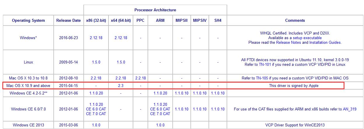

Apple have released signed drivers that provide partial support for the FTDI chip, so the communications are back for Apple MacOSX 10.12 Sierra. But we still have the issues with regard to the old firmware and the need to to use very old software versions to compile the changes to the firmware.

After the update the drivers were not working at all, but when you plugged in the printer into the Mac, the GT2560 controller would power up with the power from the USB port.
1. FTDI driver version 3.2 was reinstalled and and the printer was plugged in and no power to the GT2560.
2. Reboot and then plug in the printer and no power to the GT2560.
3. Power on the printer and plug it in and then turn off the printer power to the GT2560 remains on and accessible.
So, version 3.2 of the driver under MacOSX 10.12 Sierra does not power up the GT2560 controller without an external power source being applied to the controller. Who know if this will change in the future.
