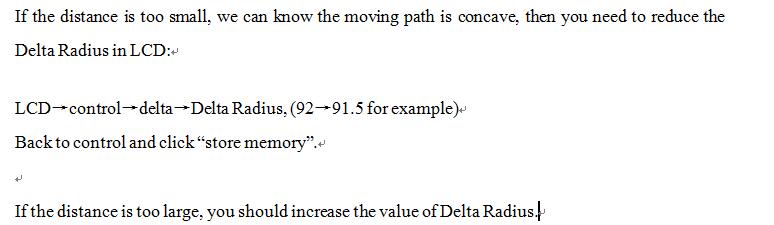

Modify the value "Delta Radius" on the LCD controller panel,see my picture plz:

Thank you William.
This worked well.
