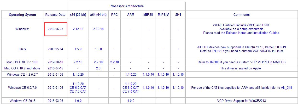

OK,i mean you can upgrade and install the driver software first,then connect the board to your PC.
http://www.ftdichip.com/Drivers/VCP.htm

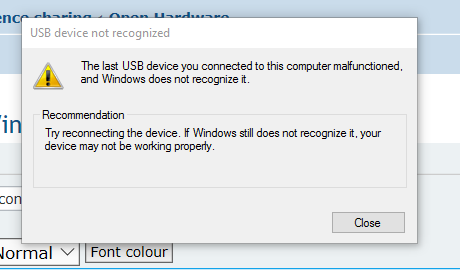

I installed the software but Im still just getting(Devices descriptor request failed) from the Pc when plugging in the GT2560? along with GT2560 2 lights Flashing 4 times - orange and blue?

I have installed this software but am unable to see a Com port. I plug in the device and still get USB device descriptor failed.
I have tried searching for new devices manager while connected but nothing.
When connected GT2560 flashes 4 times with blue and orange light but still no same error - USB device descriptor failed.

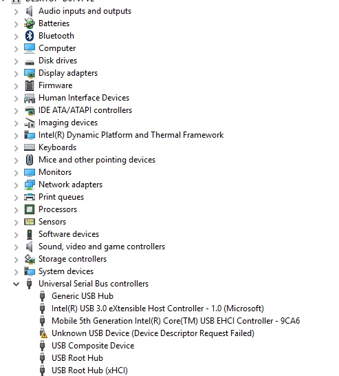

Could you attach a snapshoot of your device manager and your LED status when you connected to computer?

I have attached a screenshot of the device manager.

- Device_manager_screenshot_crop.jpg (72.09 KiB) Viewed 28146 times
