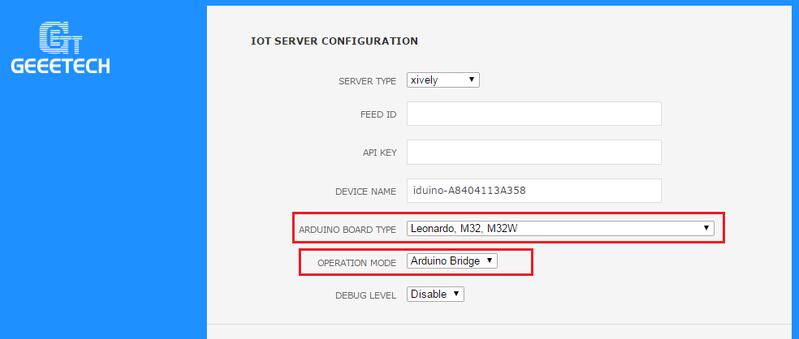

In this step did you reboot your Arduino IDE as the manual tells?
And in this step have you missed something? Can you attach more pictures about it?Thx

Thank you for the quick response! I will try to configure as you said, but:
Do I need to put Leonardo even if I have an Arduino UNO attached to the Iduino?

Re: Need help starting with Iduino Yun Shield
No,you should select the board what you attached to your Iduino board.
