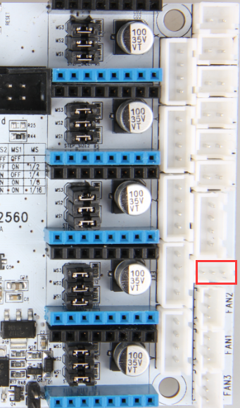

Is it Possible to Mount a PWM Fan on the Extruder2 Heater Pins?

There's a PWM fan slot on GT2560 board, didn't you see it?

I Seen the PWM Pin an i use it for layercooler.
It would be nice to have another One.
So i could shut Down the BoardCooler an the Extruder cooler after a print.
