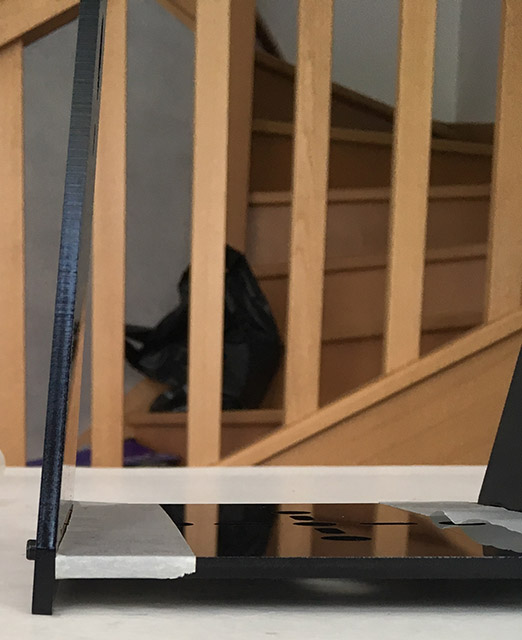

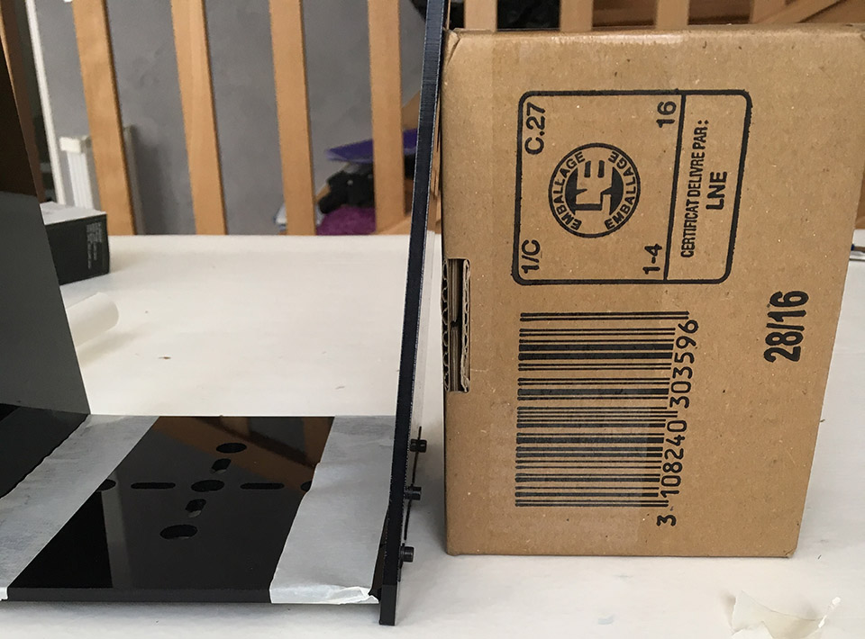

When I assembled the spool hoder... Here is what I get. You can see that the vertical acrylyc is not vertical at all... I mesured 14mm fo difference betweent the top and the bottom (thanks to the card box above)
I am afraid that the bad acrylic cut had made all my machine badly aligned, generating all my problems.
Any idea ????

This holder is placed alone,just for the filament,and it doesn't influence your machine i think...
You can adjust the 6 screws if you want it better performance.
