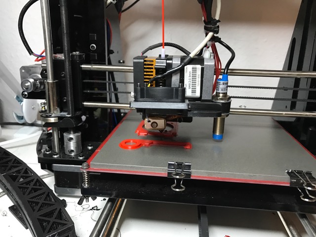

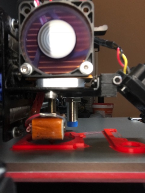

FYI, you see in the attached pictures, the assembled inductive sensor, 60mm right hand of the nozzle an 12mm in front of the nozzle.
the same high with the nozzle.

Did you watch the following video?
https://www.youtube.com/watch?v=7aav0i5cOL4
I remembered the sensor will be waiting for heating at the last measured point(that is the point you mentioned?) after it finished all the points.
Also,the printing position at the beginning is determined by the place when you load it in Repetier Host,am i wrong? :roll:

Good Moring,
yes i had see this video. my printer make the same steps, BUT start the print on the wrong position
i guess a bug in the firmware.
But i cant flash the newest Marlin Firmware, no support from Geetech.
my printer makes the following steps.
1. heat up to 65°C bed and 205°C Nozzle
2. move to home X and Y axis (G28)
3. move in the middle of the bed, home Z axis , measure with the inductive sensor (G28)
(point 2. and 3. is one command G28)
4. move to the 4 points to measure the bed --> Auto Bed Leveling (G29)
5. start to print in the upper right corner, the print had to start in the middle of the bed
That's correct, i load the object in the slicer and positioning in the middle of the shown cube.
if i deactivate the Auto Bed Leveling in the firmware, the position is correct in the middle, after activate the ABL, the printer prints wrong in the upper right corner.
Thank you!
