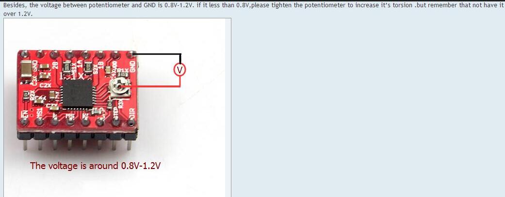

You can check if the voltage on the corresponding driver is enough:

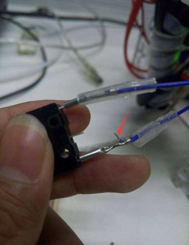

You can plug other endstop cable(X/Y endstop cable) to your "Z_min" slot on the board,then you can confirm if your Z endstop was broken or the cable on this endstop has a similar problem like the following picture:
Actually,you can measure the continuity of this cable with a multimeter.
KnowledgeIsPower

OK,
I'll swap them and see, would that explain the 10 rotations and stopping? Thanks again, you've been great help.
