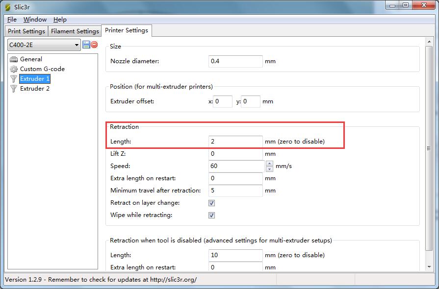

Here is a set of pictures of my latest print. There is a lot of stringing going on that I strongly believe is related to retraction:
Q1: How do I configure retraction

1.Here is the retraction setting in slicer settings:

Regarding the retraction - doesn't look better at all:
I set:
Length = 4
Minimum travel after retraction = 4
Retract on layer change = v
Wipe while retracting = v
Those the setting I've made.
Any other ideas?

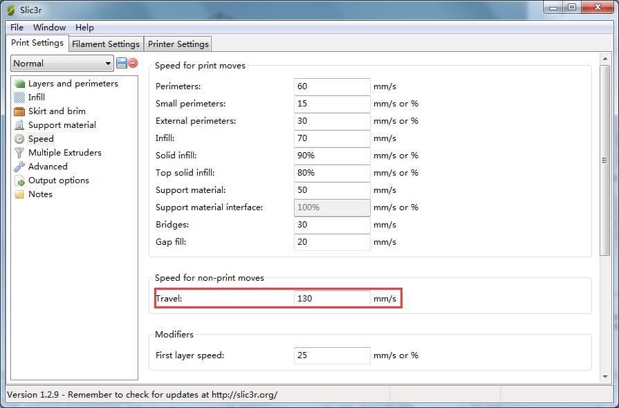

Re: Stringing and excess filament extrusion
What travel speed are you using?
You'd better increase the travel speed as long as the motor doesn't lose steps:
