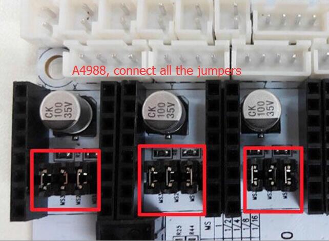

1.Did you check the subdivision?
2.Have you tried swapping the driver A4988 with other motor's?
3.Theoretically,you can modify the step/mm in "Control-Motion" and "Control->Store Memory",then the modifying will come into effect next time.

subdivision checked
subdivision checked
driver A4988 swapped
