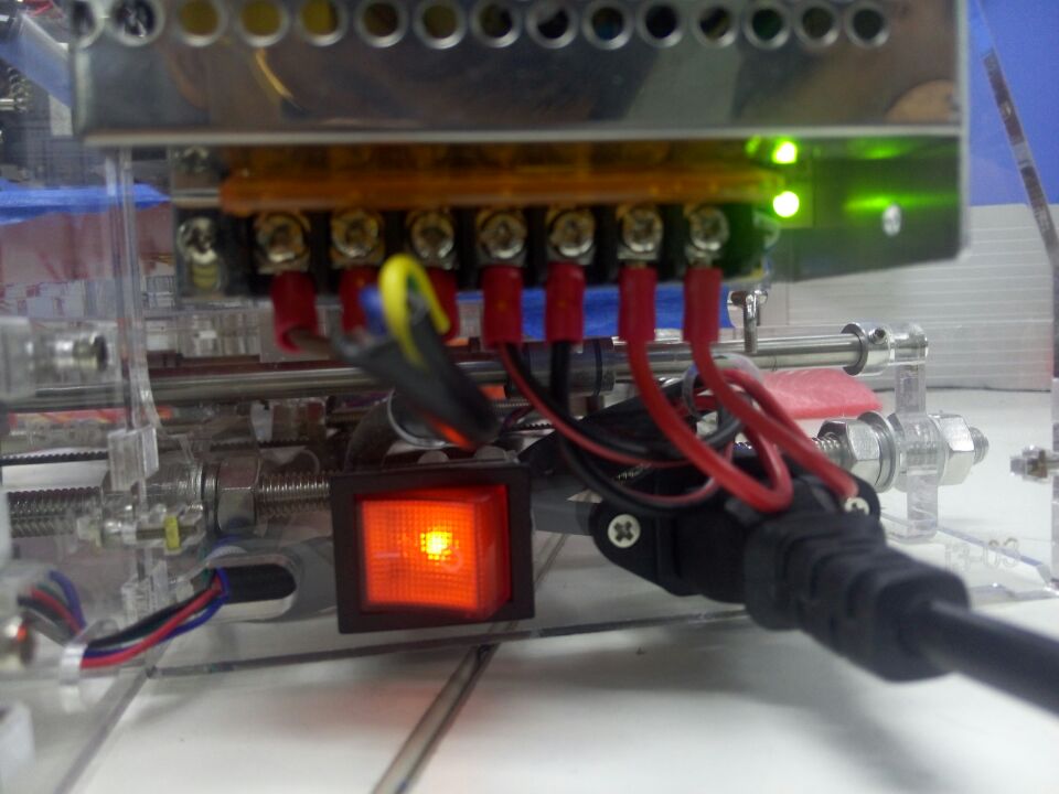

by William
Did you notice it?The green led will be on when the power is on,and what model is your printer?Did you buy S-180-12 PSU too?
power led.jpg (75.59 KiB) Viewed 16204 times

Same PSU , no the GREEN light doesn't go on but the light from the I/O does go on.
I have the prusa I3 X acrylic.
