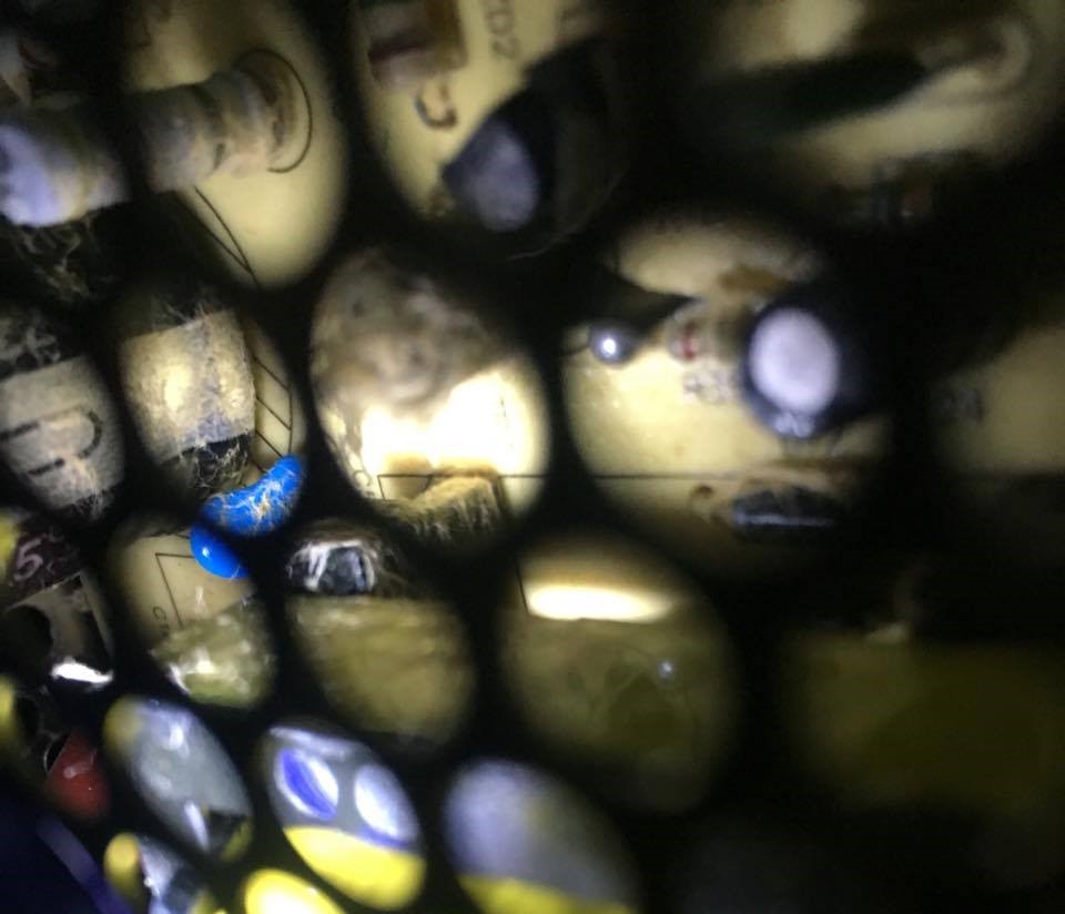

10 seconds after start up, a transistor in the PSU blew up and the printer no longer works.
- PSU_failiure.jpg (107.31 KiB) Viewed 16315 times

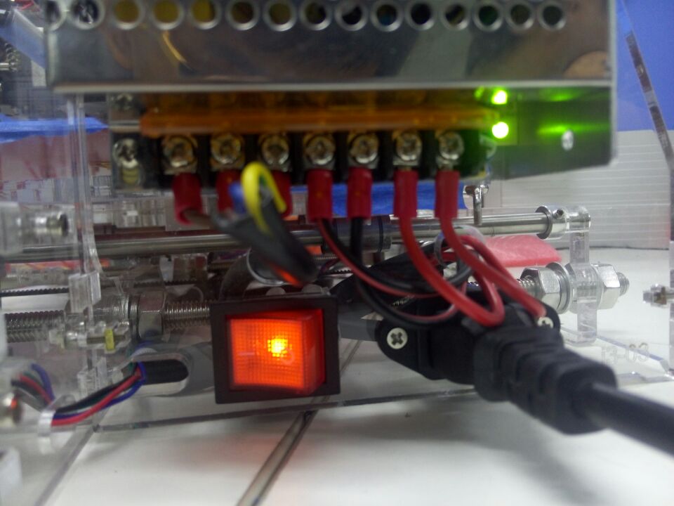

I had this problem after a year of usage, it suddenly stopped working.
I ordered a new one on geeetech after asking the type of my psu. I installed it today and the same thing happens. nothing.
I hear a slight buzz. But nothing powers on?

Re: S-180-12 PSU Failiure
The green light doesn't go on with the new one. So my guess it wouldn't go on with the older one. The light from the on/of button does go on??????
Same PSU , no the GREEN light doesn't go on but the light from the I/O does go on.
