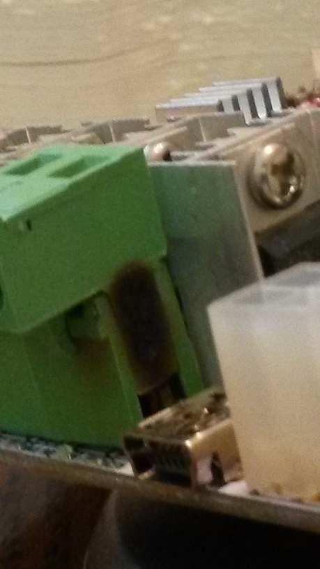

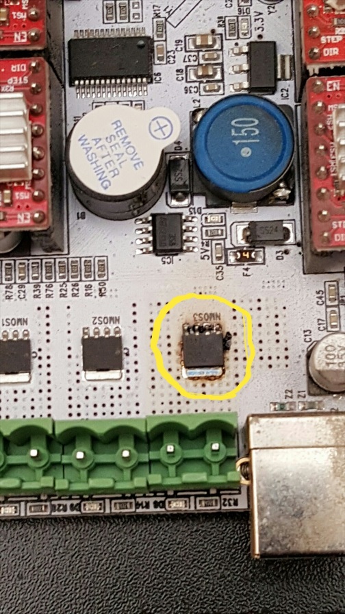

In May 2016 the control board burned out and would not heat the bed, the control board was replaced free of charge. First 2 pics In Nov 2016 the replacement board started acting up by taking 7 hours to run a 3 hour print job when printing from the sd card .

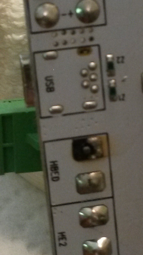

Eventually I smelled something HOT and thought I saw a small wisp of smoke and shut it down and started looking at the board and found the 3rd picture.
A replacement for this board is not Free !! 3rd pic

The first 2 pictures were of my first board (older version) and had larger chips with heat sinks.
the 3rd picture is of the replacement board (newer version) and has smaller chips mounted flat on the board and
no mention was ever made about mounting heat sinks on them.

The first board was a Rev. A board and was replaced in May because it burned out the connectors for the heat bed (see pictures #1 and 2)
The current board is a Rev. B board (see picture #3) and has a burned out transistor circled in yellow ! What I wanted to know "is the circled transistor associated with the heated bed circuit ?
When I smelled something burning and saw smoke I turned it off and uninstalled the control board from the printer to get the picture

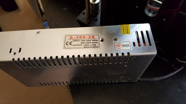

As far as the PSU is concerned it's ouput is 24 volts , but you said they ship with a 24 volt 18.8 amp PSU ,BUT MY PSU IS 24 VOLT 15 AMP PSU

You stated that M201 printers ship with 24v 18.8A power supply, but my parts list states 24v 10-15A power supply and that is what I have (see picture)
