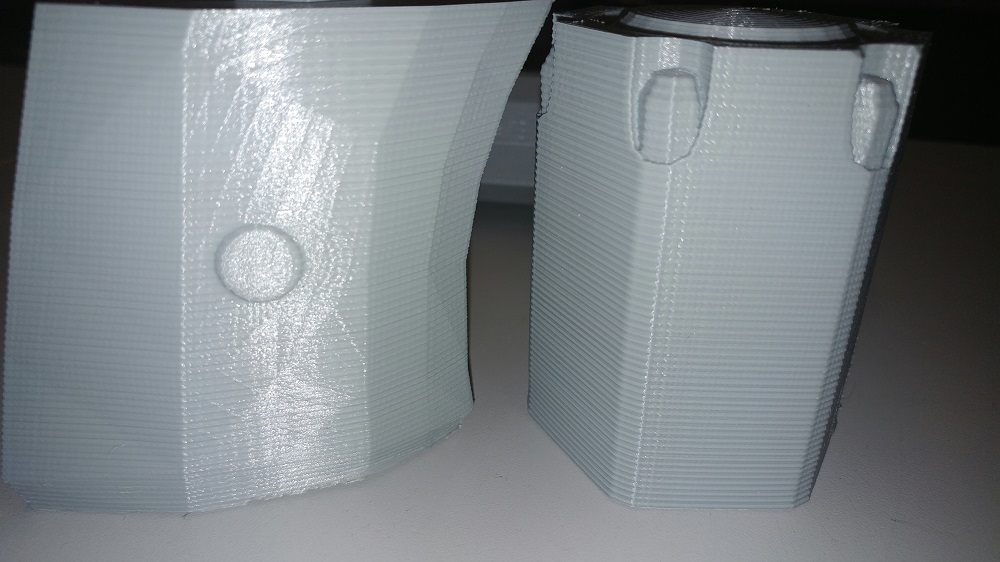

bought a i3 pro b last year and printed out the project that I was trying to get done. Wan't overly happy with the quality.
I now have some projects that I am trying to get done and I have the same quality issues. It is a problem where I get "layer" lines. (photo attached).
I don't know if this is a firmware issue or do I have to tweak anything?
any suggestions would be appreciated.

- 20161205_151134_resized.jpg (146.15 KiB) Viewed 6182 times

I think I see the problem. When the print head is moving on the z-axis you can see the print head rock back and forth in the y-axis.
I have seen some "anti wobble" parts that can be printed. is this something that can help with this?

Re: layer lines
Here it is:
http://www.thingiverse.com/thing:1424358
