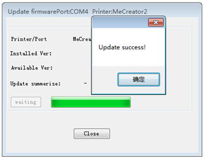

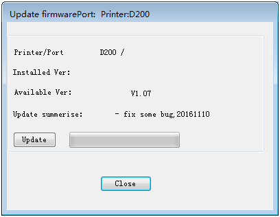

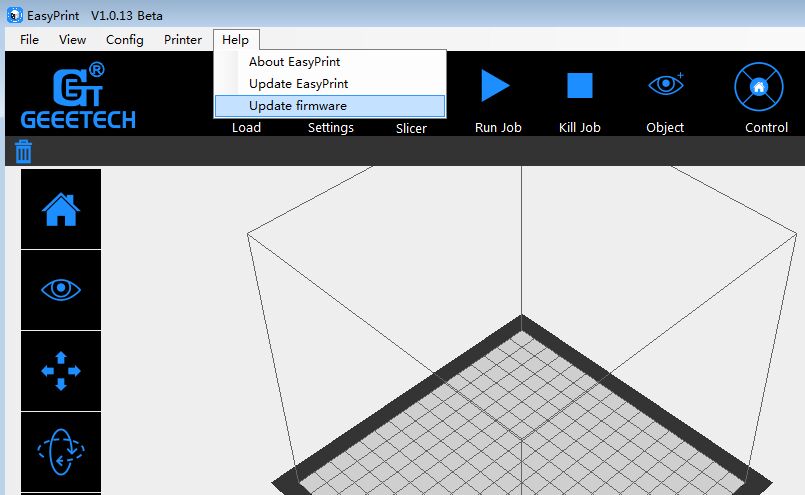

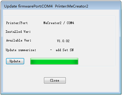

Easy Print provides all the users with online service of upgrading firmware to guarantee perfect printing performance.
The specific method is as follows:
1. Connect your GEEETECH 3D printer to the computer with the USB cable.
2. Turn the printer on.
3. In Easy Print, choose the COM port and the printer type.
4. Click ’help’> 'Update firmware'.
After clicking the [upgrade firmware] tab, a window will pop up with the information of printer type and port, the current firmware version installed, the available version and the update summary of the latest firmware. Click [update] and confirm updating, the progress bar will turn green; the firmware will be updated automatically. This process may take some time. When the upload is complete the message ‘update success’ will be displayed.
Click ‘ok’ and ‘Close’ on the windows to complete the firmware upgrade.
