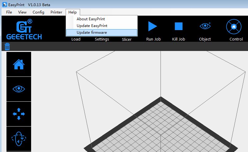

3. In Easy Print, choose the COM port and the printer type.
4. Click ’help’> 'Update firmware'.

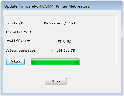

After clicking the [upgrade firmware] tab, a window will pop up with the information of printer type and port, the current firmware version installed, the available version and the update summary of the latest firmware.
upgrade firmware
upgrade firmware
Easy Print2.jpg (55.95 KiB) Viewed 38528 times
upgrade firmware
upgrade firmware
upgrade firmware2.png (9.46 KiB) Viewed 38633 times
Click [update] and confirm updating, the progress bar will turn green; the firmware will be updated automatically. This process may take some time.

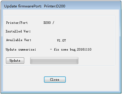

upgrade firmware
upgrade firmware
upgrade firmware3.png (9 KiB) Viewed 38633 times
When the upload is complete the message ‘update success’ will be displayed.
upgrade firmware
upgrade firmware
upgrade firmware4.png (10.45 KiB) Viewed 38633 times
Click ‘ok’ and ‘Close’ on the windows to complete the firmware upgrade.
