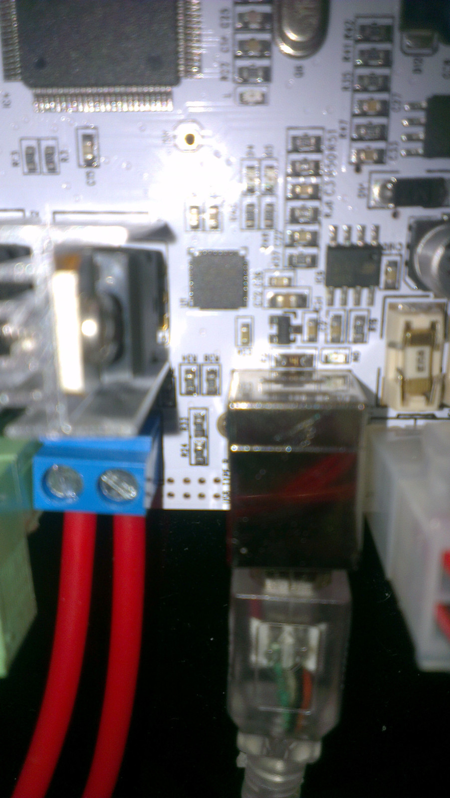

So strange...
Could you attach a picture of your FTDI chip on the board(next to the USB port)?

Here is the image, I hop the quality is OK.
- Booard.jpg (326.39 KiB) Viewed 24085 times
Re: USB connection stops working
It's dim...Can't read the numbers on that chip...cRaZyT wrote:Here is the image, I hop the quality is OK.
