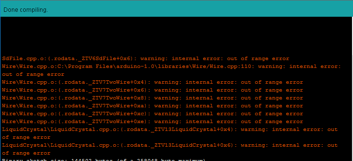

A- manually editing the original firmware as per the instructions - when i do this i get the "LCD error as per the image" when i try to compile. if i ignore this error and upload then the LCD screen is all black. (with Arduino 1.0)
B -using the supplied firmware here - viewtopic.php?f=27&t=18263 . i get the same error as in A (with Arduino 1.0)
C -using the firmware by NiclasO - viewtopic.php?f=20&t=18437 this compiles and uploads with Arduino IDE
I have resoldered the 3 pin connector and rechecked- no issues.
:? :cry:
What i would like is to use the firmware that is original by William here viewtopic.php?f=27&t=18263 and why will it not compile but says the error below?
LCD error.PNG (18.84 KiB) Viewed 9980 times

it seems the firmware compiles when i ADD // in front of use auto bed levelling, and wont compile as soon as i remove the //
so the issue must be something that is being called with that statement.

OK
i was using wrong arduino- needed to be 1.0.1
i cna now compile the firmware BUT - the sensor still wont work as per original post
